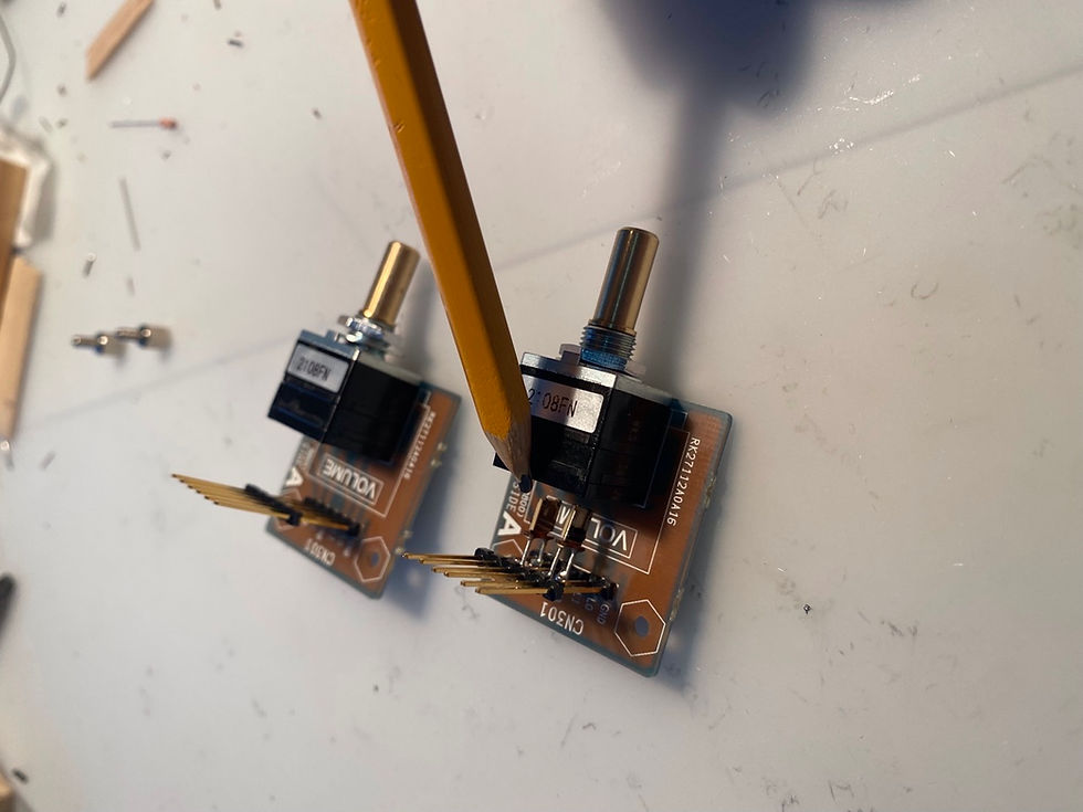

A look at the mod:
Top of volume pot module. On the right, Vishay Z foils added to left and right channel input pins (pins cut). The pot on left is for comparison and left stock as a spare.
Bottom of volume pot board. Vishay Z foils added from input to ground after the input resistors.
