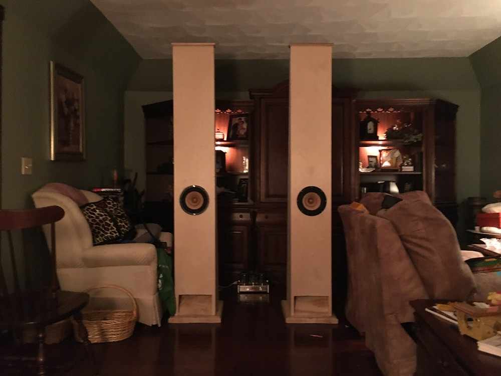

After a lot of back an forwards I ended up building this design. I know I wanted big sound an high efficiency. This is a simple design, no crossover network, and a 8 inch full range speaker. If you have any questions please let me know. As always there’s a few thing I would do differently. Stay Safe out there

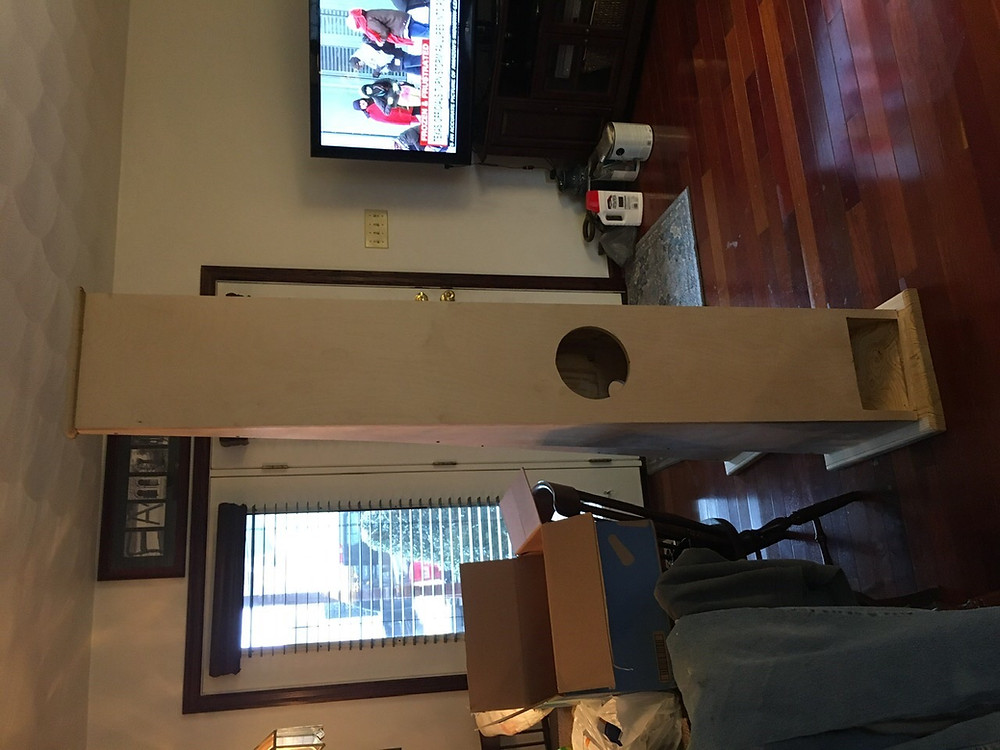

@roblund7 I used 3/4 inch baltic Birch plywood an lined the cabinets with 1/4 inch standard plywood if I were to do it again I would use 3/4 inch Cheery faced plywood
Hey @roblund7 , I used the design from Teck Ingredients YouTube channel I followed it about as close possible. I used Flex Seal to glue the 1/4 inch liner in the speakers I’m not sure that’s even necessary. They do sound great though I used Tang Band w8 1772 full range speakers But I’m sure a Dayton full range speaker would sound good also I think you could make these speakers out of cardboard and they would sound good. Those guys in The Golden Age of Audio sure new what they were doing

@Robby’s Music Robby they sound better than I could ever hoped for. They sound so good I’m kinda at a standstill. I don’t want to stop using them long enough to put a finish on them. Im kind of leaning towards a veneer. If I was to do again I would use Cheery Plywood. I used 3/4 inch Baltic Birch for the strength . I’m not sure that was necessary, but they do sound great !!!
